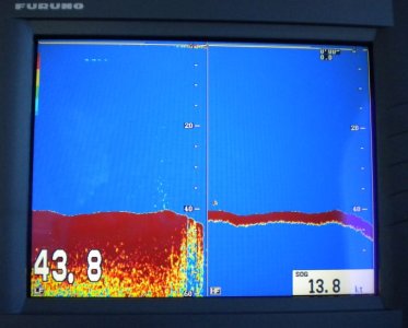

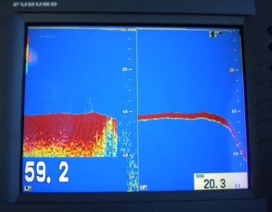

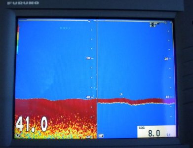

It is most likely turbulence going over the face of the transducer. The easiest way to tell is by looking for gaps in the bottom on the 50khz side when you are traveling at different speeds. Do you have any pictures of how the transducer is mounted? Remember that 50Khz is more prone to turbulence than 200Khz so using 200Khz when running is a better choice. Below is a classic example of what turbulence will look like. Also I would set your TX power to 100% and TX Rate to 10.

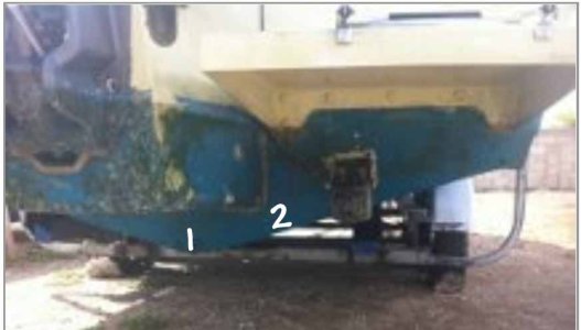

I tried the settings you gave me and there was a lot of improvement. Got depth reading up tp 1343 feet guess was the deepest water I was fishing at. Still having a challenge with the transducer reading while the boat is on plane. I discovered that the wash hits directly at the transducer and it might be a good idea to move it nearer to the keel. The problem is that the outboard bracket is in the way.

Thanks for posting another picture of your boat. Sounds like the setting changes helped so that's a step in the right direction. Experience has shown that the best water flow is as close to the keel (centerline) as possible. But for most vessels this is not a viable because of (A) the location of the drain plug and (B) they have a single engine. So the trick is to pick a location as close to centerline at won't affect the water flow to the prop when going straight. Once you have a suitable location I like to have a mount that has some range of adjustment to it. This way you can try different transducer depths and tilts to see how it affects the sounders performance without drilling a bunch of holes in your transom. From your picture it looks like you could move the transducer more inboard next to the engine bracket (location 2), true?

Thanks for the response Snips. Agree with your suggestion. The engine is on a bracket about 30 inches behind the transducer so I doubt if it will be in the way of the engine.
Will move it nearer to keel. Will repaint bottom and drop her in in four weeks so wont be able to report on this before.

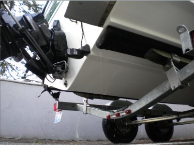

Turbulence will take away fish targets. Your screen shot in 1300+ft is showing a weaker bottom than I would expect to see. The fish alarm does work if set up properly. One other item is to check is that your transducer is pointed straight down. It just may be the angle that your picture was taken at but it looks like the transducer is pointed slightly off to starboard.
laram51
Here we go again Snips, and sorry about the dirty bottom. Will paint soon and drop her in. Hope this will improve the situation with the new location of TM260. Will give you a report when done. If this does not improve the situation someone said to install it in the bilge. 24 ' Proline and all the space I have is about an 18X18 with the hull about 1/4 thick. I also read about a tank for the old m260 which could be retrofitted.
