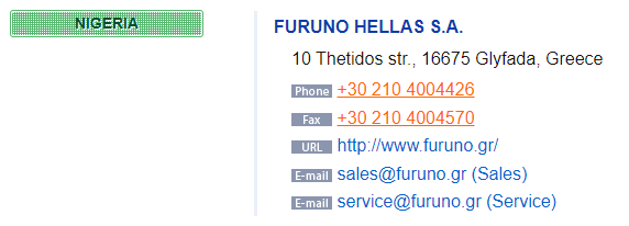

Please can you connect/share any contact with me either; with the supply channels for Hard drive 001-074-480 or special ordered PN 001-495-260-00, am in Nigeria, West Africa
