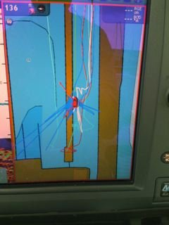

My MFD 12 shows some really strange trails.In this shot, I was motoring towards the pier on the right when the display suddenly moved me to the center of the pier on the left and back in an instant with the resulting track. I did not go there.

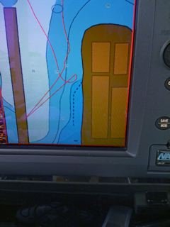

In the second shot, the boat was tied up at a pier. The tracks blue show random movements toward the bottom left as well as a few to the right of the screen

Based on the screen shots, I would have to say you are receiving some interference either from something on the boat or surrounding area. The GPS signal DOP (Dilution of precision) is most likely increasing. For example, we have had some recent reports in the Charleston area (city harbor) that a local WIFI booster that someone has installed was/is causing boaters problems with their GPS signal. I would recommend you ensure that you don’t have anything on your boat that could be the cause and keep an eye on the location(s) you see this issue. There also has been “notice to mariners” in the past about TV amps on boats, causing GPS issues. You can always bring up your GPS status screen and check the signal levels and DOP of your GPS receiver. You might want to monitor it and see if you see your DOP suddenly increase. Normally you want your DOP to be around 1 to 1.5 . The lower DOP number, the better. You might speak with some of your fellow boaters at your dock to see if they have noticed any GPS issues in the area. It is important your GPS is placed away from transmitting or noise sources. For example you do not want your GPS within your radar transmission beam.

If you have your tracking set to “TIME” instead of distance; the tracking will not normally show the GPS drift. Small amounts of GPS drift are normal. If you have large GPS jumps in location, the problem is normally related to on boat transmissions from other sources, or local area transmission. If your problem occurs regardless of location, you should contact a dealer to help you locate the source of the on boat interference or evaluate the GPS unit. If you think the problem is related to your GPS unit then you could have the unit checked. If your GPS is Furuno, you can send the unit in for full testing/evaluation to our factory service center. RF Interference is the most common cause of this issue.
