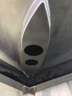

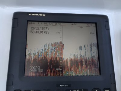

Gday guys, just after some thoughts on my 295 picture. I am running the 82B 35R 2kw and the 200B 8B 2kw. I get a perfect picture in less than 100m but it gets a bit ordinary in the little bit deeper. I have just been doing a bit of research and I am now thinking possibly tx power or tx rate? Could this be a possibility? It will be set at factory settings as this is not something I have ever played with. This is a picture of my issue and transducer setup. Any advice is extremely welcome.
Cheers
Lee
Anyweather,
Thanks for the screen shot and nice looking fairing. However the screen shot doesn't offer much to go on, What is more helpful is a screen shot starting at 0 instead of a shifted display starting at 266m. Seeing the total water column can yield more clues to what is going on.

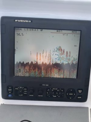

Hi Snips, thanks for the reply. It will be a couple of weeks until I get back out again so I will try and get some more screen shots then. I just checked the tx power and rate and they are at 10 and 20 so I need to be looking elsewhere I think. I will add another screen shot of what I have however it is also a shifted version to show what I mean by getting a good picture in shallower water
