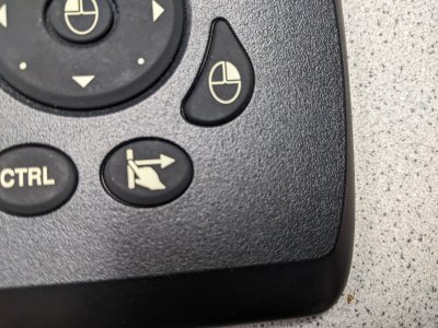

Don't have swipe capability. using msu-001 keypad. Yes tracks are on tried both time 1 minute and distance .05 NM. its like the track buffer is full. Finally deleted all track points still no worky. same problem on tracks freezing on overnite trip.

I used the conversion kit that makes the key board work with the mcu001 guess i should have said 005? Yes it still doesn't work even though track is on. Maybe the gpa 017 gps antennae the culprit??
Not sure how the boat yard wired it.
