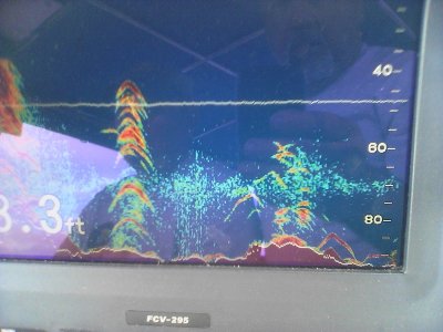

very remarkable difference in a good way.
clutter and color erase decreased significantly

wondering if i could set the hf side to a bandwidth of 100 to use the full frequency range on that side of the transducer
Teffy,
The FCV-295 is blocked from working in three different frequency ranges; 52-65, 111-139 and 171-183Khz. So if you set the HF to 200khz the lowest you will be able to go is 183Khz. If you want to go lower I suggest resetting the frequency to 151Khz and then you will be able the check the frequencies from 139 to 171Khz.
