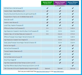

Thank you for inquiry. Please see the photo below, I found this on the Sirius Marine Weather website. I am a little confused on your questions. With the offshore package the information below explains a 5 day weather forecast and only up to 48 hours for wind.

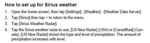

Please refer to the the photo below to verify your TZT2 setup using Sirius Satellite Weather. After verifying your settings, if you are still having issues please let us know and we can work through the next steps.
Thanks for the reply. Upon closer inspection, I see that the forecast days slider is under the NavCenter download section, and has nothing to do with Sirius weather. I also took a closer look at the capabilities of the offshore package, and you are correct -- I only get 48 hours of wind forecasts and wave information. So I guess that is the answer -- Sirius weather has limited capability, even when one chooses the most expensive offshore package. At least I theoretically get roadside fuel prices and sports scores, though I have not seen them yet. The other drawback of this system is that you can never turn off the TZT2, or it will have to begin the long process all over. This morning, for the first time, the TZT2 spontaneously rebooted for some reason, wiping out all the data that had been so painstakingly gathered over the past few days.
