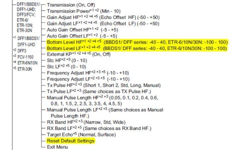

This summer, the automatic bottom lock stop working. My DFF1 have work flawlessly since 2009. When put in bottom lock mode, it just expand the depth scale to 800m and stays there, no matter how deep it is. The sounder gives correct depth info in figures, but it looks like the picture speed is slower than the 4/1 it´s setup for.
Used in manual mode, tuned for the measured depth, the bottom display shows the bottom the way it´s supposed to do.
What can be wrong?
