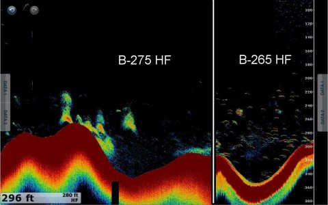

The two choices I would consider would be either the B-265 or B-275. The 12 degree beam out of the P-66 is the 200Khz side. Neither of the Chirps transducers have that beam width. The HF of the B-265 is 4 degrees and the HF of the B-275 is 25, both have the same LF beam width.

The B-765 is a 600 watt transducer and is not compatible with the UHD. Here in the US the 275 is gaining in popularity because of its wider HF beam width.

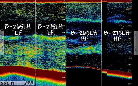

Sorry I have never tested the UHD with a B-175. If you are fishing on uneven seabed's I would recommend as narrow of beam possible.
Aggeloscyp,
As you can see from this screen shot the HF of the B-265 will do a better job.
