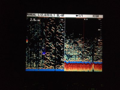

Septimus,
Connecting the FCV-1150 to an SC-50 really won't help the sounders fish detection capabilities. It will just smooth out the bottom on the right side of the display. Below is a screen shot of an 1150 that's not connected to a sat compass and you can see as the vessel goes up and down so does the bottom in the normal display.

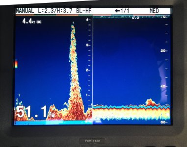

Septimus,
Are you talking about using the full screen and just have it ranged in just to see the bottom? You could run the 1150 like that but I think you will always be adjusting the range to keep the bottom where you want it. If it were my vessel and I already had the SC-50 I would connect it to help smooth out the bottom. But using the BL mode will give you the arches you are looking for even without connecting to an SC-50, as long as the 1150 isn't getting interference from another sounder, which is what is happening on the left side of this screen shot.
