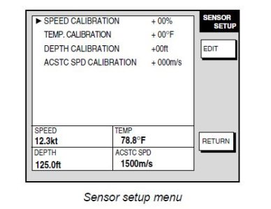

On VX2 it is actually called depth calibration and is in the sensor setup menu. Make sure that both displays are set the same. Also check to make sure that the ACSTC (acoustic) SPD (speed) calibration are set the same.

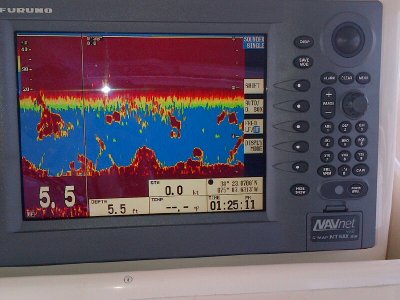

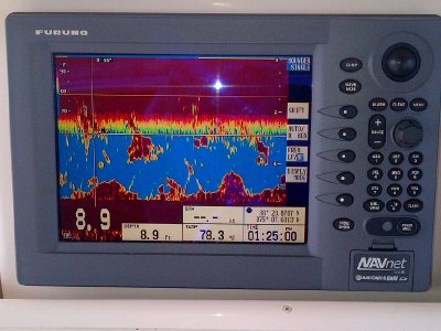

Sir - I checked both units this weekend and I'm still getting different depth readings. See attached photos. The unit reading 8.9 is the main unit (left one) and the other is the ghost one which is connected to the main unit and then to network. Why am I still getting different readings? Checked everything.

Grady28,

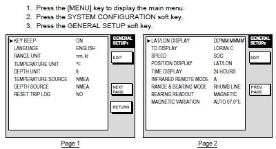

Thanks for the screen shots. I see that you have Temp & STW on one display and not on the other. Double check on the General Setup page that the sensor sources are set the same for both displays. The Depth source should be set as ETR if you are using the BBFF1 or DFF1.
