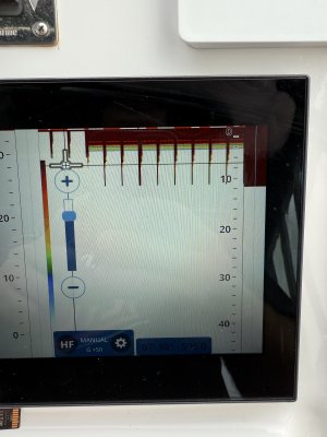

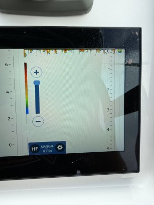

I’ve got two GP1971 units — one set up as a sounder and the other as a fish finder. The other day while out on the boat, I noticed I wasn’t getting a bottom reading on one of them.
I checked the P66 transducer and saw it had unclipped up, so I clipped it back into place. Still no bottom reading — just the temperature showing
I tried unplugging the transducer from that GP1971 and plugging it into my other unit, and it worked perfectly there (reading both temp and bottom fine). So the transducer itself seems to be okay.
Has anyone come across this before or have any ideas?
Could it be a setting, a software issue, or something wrong with the sounder input on that unit?
Appreciate any help — cheers!
