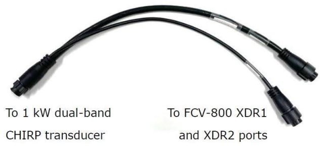

I’m currently running 2x GP1971 sounders and looking to upgrade from my p66 transducer. Currious if anyone can tell me if a B265LH transducer can be run on my two sounders, high on one mfd and low on the other. This would be achieved by using a splitter that is now used for FCV800 (image attached).

I have been told it will work. Setting on the mfd 1 is set to b175h and setting on mfd 2 will be b175l. Dealer installing in a couple of weeks, I’ll let you know.

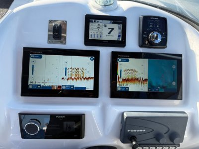

Hi mate, yes installed the B265LH. Have only taken it out for a quick spin the other day but seems to be reading fine. Getting a slight bit of interference between the L and H but can seem to filter it out ok.
