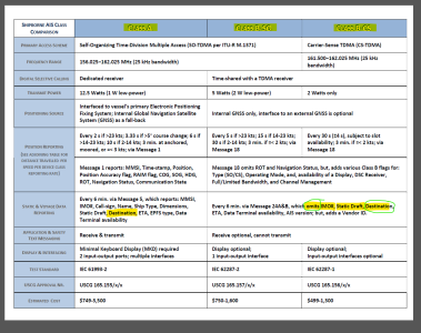

I just installed an FA70 and it’s working well on the dock. I’m curious how you set the destination on the FA70. I assumed I would just see an option to do that from the TZT2.
Thanks,
Chris
