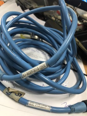

It means that it can connect with Nav Net 10' display only via Network port on 7" and 10" display, right? Can not connect to any VGA monitor, right? I found the NavNet Ethernet cable, Pleae help me to check it if it correct. Thanks so much for your help

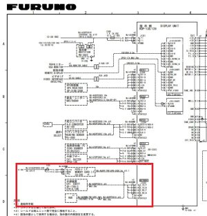

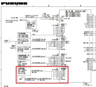

Sorry for the late reply, but that's it...
The network cable you have will go to the network port of the 1732c and to the network port of the 1833c.
