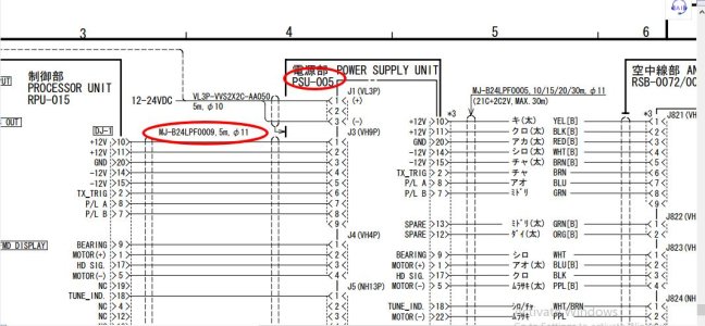

linhkienbodam Furuno Super Fan Oct 6, 2025 #1 My radar is Furuno 1954C. The signal cable between RPU 015 and PSU 005 is damaged (the original cable length is 5m), I can reuse 2 meters from the old cable, will it work well with 2m cable ? if not what is the shortest cable length between them?
FishTech Obstacle Wrangler Staff member Oct 6, 2025 #2 You should be fine. You will have to check the timing again after shortening the cable.
