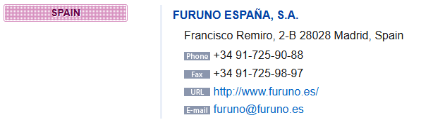

I would recommend calling Furuno Spain because if there is an across the board issue they would be aware. I do know that if your unit was upgraded to version 25.11.2 (For Europe only) all internet functions have been disabled until the next software due to EU Red Cyber requirements that just went into effect.
thank you I will do that tomorrow morning and let you know. For nowI can tell you that I have version 25.11.1 not v2 as I suppose they have retired the version till they solve the issue you mentioned. I tried to upgrade to the version you mention and it sas I have the lastest one. Its weird as the app iboat updates my zone without any problems but not my tztouch
