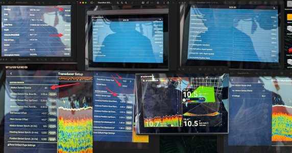

Thanks so much @Deep Blue and @Sparky Wire for your cvomments. I weanted to ask you something. where do I need to play with those adjustments as I can modyfy offset of those things in two places. ( Inside the menu of the SCX -20) where you configure satellites too or inside the transducer setup where you select the motion sensor SC X 20 below you have also pitch and roll offset. Attached to captures to show you . One of the transducer setup and another one showing the manual of the scx20 showing the section inside config of SCX 20.
thanks in advance!

The offsets are to adjust when the SCX20 is not mounted exactly flat. So if it is pitched 5 degrees, you would put that offset in to compensate. When it comes to the DFF3D you will either us the imbedded pitch/roll sensor mounted in the transducer OR the SAT Compass pitch/roll sensor.
Hi @sparkywire. thanks for letting me know this is what I understood at the beginning. I´ve used the roll offset inside the configuration menu of the SCX 20 to compensate a 3 degree position on the installation of my SCX 20. to make sure all looks good in the multifunction display furuno. But after talking in that thread I understood that maybe touching the roll and the pitch offset I could maybe avoud a little the effect on the sounder? in my case the Pitch degree offset inside the config of SCX 20 seems 0. how can I make sure this is correct? and regarding the offset inside the menu of the transucer I ´ve atrtached on my previous message is this the same as the one in the config of the menu of the SCX 20? It sould I suppose but I think its not. In that case it´s diferent should I put the same values?
Another think I don´t understand is this that is on the website of furuno in the SCX 20 page. if that is not possible why they put this? in my case it´s not working if not I shoudn´t see the image I´m attaching as it´s not compensating it
