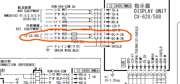

R Rocha New member Oct 7, 2023 #1 Sonda 628 no enciende, vcc de entrada 13.6, hay ciertos voltajes presente
Titanic II Moderator Staff member Oct 9, 2023 #2 Make sure the Black wire with the fuse is connected to the - (neg) side of the battery. Disconnect the drain (shield gnd) wire if it is connected. The shield wire is a bare wire with heat-shrink over it. Attachments fcv628 pwr.png 69 KB · Views: 0
