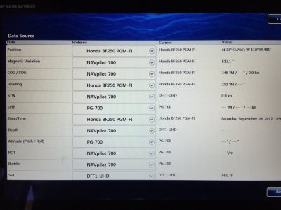

To me it sounds strange that the honda nema is my data source and not my furuno GP330 sensor. Yet the Honda nema is my only option in the data source list
Is my data source set up correctly?

"....Yet the Honda nema is my only option in the data source list"

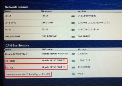

in the data source list, under the column labeled PREFERRED, the boxes for position, date/time, and heading it currently shows that HONDA engine info is the source. If you click on the little drop down arrow next to the Honda engine currently selected, are you given the choice to select the GP330B as possible selection? If so, please set this as the preferred source of position, date & time. The GP330B does not provide heading , you would need another source (such as the PG700 compass).
For the drop down only the honda is the source available, there are no other choices to pick.

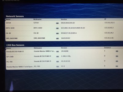

Take a look at your sensor list and pay close attention to the "Nicknames" that you can set for each device. the Nicknames that you set will also reflect on the data source page.
For example: If I set my GP-330B's nickname to "DB", then when I go to my data source page and select a position source, the "DB" nickname will show up instead of GP-330B.
That being said, your nicknames are set to the same name and also incorrect names that probably make it really confusing when selecting correct data sources like you are experiencing.
First step is to change the nicknames of the GP-330B, PG-700, and Honda Marine NMEA interface to reflect their actual equipment name/nomenclature, in the sensor list page.
