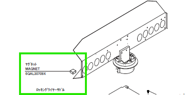

Ensure the magnet is on one side of the array on the bottom. The magnet needs to come in close proximity to the reed switch when the array is facing zero degrees forward. With power removed follow the two wires from the switch to the connector jack, put your meter leads across the connector with it connected. You should read approx. 300 when the switch is made and an open when not made.
Thanks for the reply. I did check to make sure the magnet was there when I replaced the reed switch. But also, if the magnet had fallen off I don't think the radar would work for a while then lose the heading signal. It's like something is heating up then failing, then working again after coolin off. I just don't know enough about the unit to know which component that might be.
