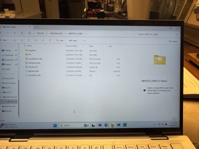

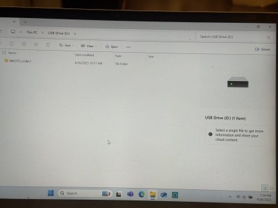

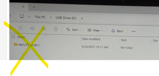

Can't have that folder sitting on the root of the memory. The items you have after opening that folder should be what is sitting on the root of the memory. The system is not seeing past that folder. That is why the update isn't working.
ok we got the stick to work , updated the machine. Still not saving tracks ? Now what . Its happening to both machines.

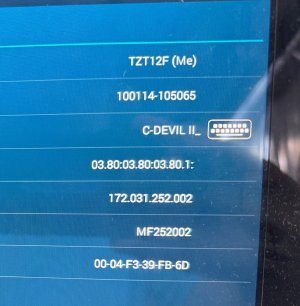

We did some testing and have verified that TZTouchXL has this as a bug with V25.11.1 and based on this thread we will be investigating the TZTouch3 V3.80.1 as well. Everything here points to it being only with the most recent updates. Those with mixed systems could split them by generation and see if the problem occurs on one or both.

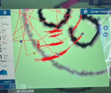

I tried everything still having a problem also noticed when anchoring my track used to draw my swing , i would let out some anchor line to drop back and it would also show the track swing on anchor, Now when I let out anchor line it erases where i was before letting out line drawas a straight line to the next spot when I stop letting line out.
This is normal and a feature request that I have passed up previously. For a short period of time the track is a very high resolution before it then changes over to the setting in the menu which is a lower resolution.
That looks different than what I was describing. They're investigating it now so I would revisit after the next software.
