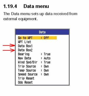

This could be a silly question but.... In my 295 I am not able to set the temperature, only the graphs. Do you have any idea how could display it in numbers instead of the graph.

You must first turn on one of the two Data boxes and then select what you want to be displayed. Section 1.19.4 pages 23/24.

Thank you for the prompt reply, I will check and see what happens! :D
