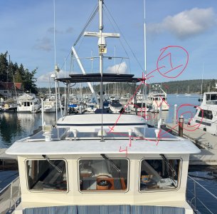

Got another question on this topic. See attached picture.
My preferred location to install the SCX would be #2, replacing one of the GPS antennas. This would be 4' away from the starlink and 2' lateral separation but minimal shading from any obstructions. Location #1 is 8' away from starlink but longer cable run and some shading from mast and a more complicated mount. The HF antenna is going away so that shouldn't be a concern
Garmin Open Array radar is being replaced with a Furuno DRS4NXT 24". If I'm doing the math correctly at location #2 forward on the pilothouse roof there would ample margin from the 11 degree downbeam.
Appreciate and advice and thoughts.
