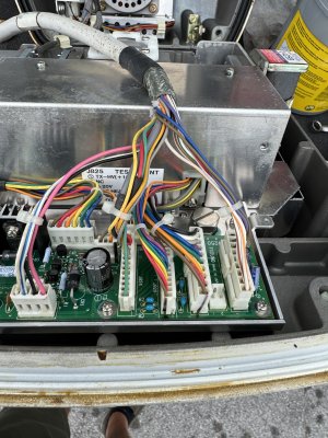

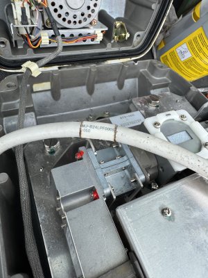

You would need to find what you need on the used market. The 24pin connector is molded onto the cable so you would need to find a replacement or splice it back on properly.

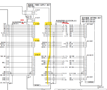

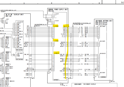

Ok I think I only have one last question for you guy’s, I have a 37’ cable that I want to use for my 1934c 12kw to connect from my VX2 to the PU-005 that I need to terminate the Molex connector and pins to could I shorten that cable to 30’ without an issue is there a magic number in ft that is acceptable? Or shorter?Regarding the little molex connectors here are some part numbers.
VH9 Housing - 000-505-893
VH4 Housing -000-505-887
VH Pins - 000-100-049
NH13 Housing - 000-505-610
NH Pins - 000-505-504
