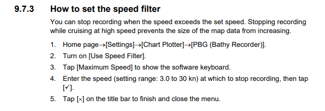

I have updated the tzt16f with the v3.70.1 software. Since then I cannot record and the 3d is not working as well.
Ensure you have heading, that the speed isn't too fast or slow. If you have tide graph in the NavData boxes; remove it. The tide graph is reported to be causing some machine slowdowns with v3.70.1 but will be addressed in the next software version.

Heading and GPS position are a requirement to record PBG. Normally the heading source like your autopilot should be turned ON. Heading can be checked in a data box to see if you have numbers.
