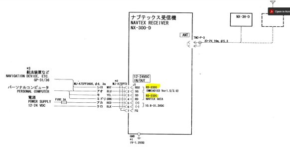

I have a Navtex NX300 and want to feed it GPS data from my NMEA0183 network. The wiring diagram on page 61 of the manual suggests that White + and Blue - should be the wires I use, but it's not working. I've also spoken with Furuno tech support (who were very nice but ultimately unable to resolve the issue).

NMEA 0183 historically could be transmitted at RS422 or RS232 signal levels. It wasn't until recent times that RS422 became the established level for 0183. In the case of the NX300, it talks at Serial PC level (RS232 level) 0183 as indicated in the interconnection drawing below.
Do you have an RS232 level source? If not, then to properly connect a RS422 source, you would need a level converter (RS422/RS232). I am guessing that is why you are having difficulties. You don't put diesel gas in an unleaded car, nor should you put RS422 0183 into a RS232 0183 unit. The level converter or the RS232 source of GPS would be connected to the SG (Signal Ground) [BLUE} and the RD (Receive Data)[GREEN] wires to receive and process the GPS data on port 1. If receive port 1 is use, you can always use RD2 (receive data 2) instead. [WHITE]

If you want the connection to be bi-directional it would be wired like this...
NX300 to 9-pin Serial
BLUE -- Pin 5
YELLOW -- Pin 2
GREEN -- Pin 3
I also recommend that you place two jumpers on that same end of the 9 pin serial to loop flow control and error correction.
Jumper Pin 4 to 6
Jumper Pin 7 to 8
If you only want to single direction (GPS into the NX300 only) you can leave off the Yellow wire (pin 2 of the 9 pin serial)
