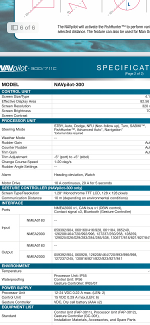

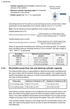

The octopus variable Piston pump AF1212 looks suitable size for my system, and NP300 with max amp 19amp.
however is not listed in the Navpilot300 pump list FAQ/ install manual.
Is it not recommended? Does it require a geared pump? Going around in circles trying to not overpower the system with too high a flow rate pump and avoid the extra cost of NP711C
