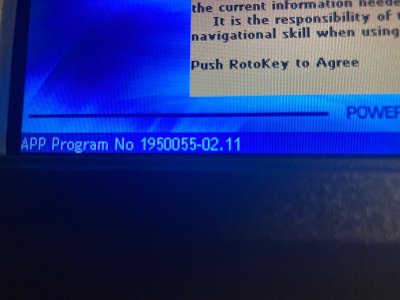

Hello. I took my old NavNet 3d MFD8 device off the shelf. I want to update it to the latest software version.

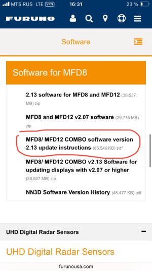

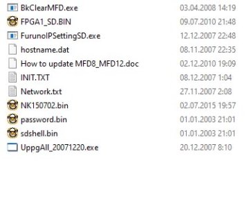

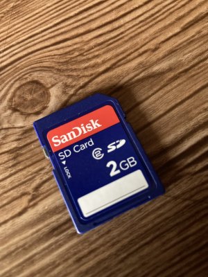

1. I downloaded the file "MFD8-12 1950055 0213" and wrote it to an SD card (FAT system - 1 gigabyte)

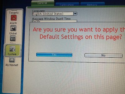

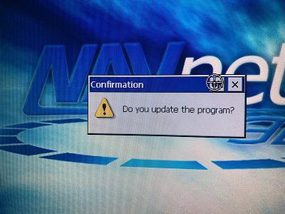

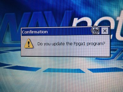

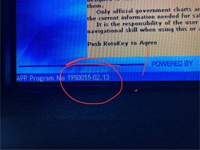

2. Following the instructions, I inserted the card into the top slot and turned on the device. I made two confirmations. The device loaded.

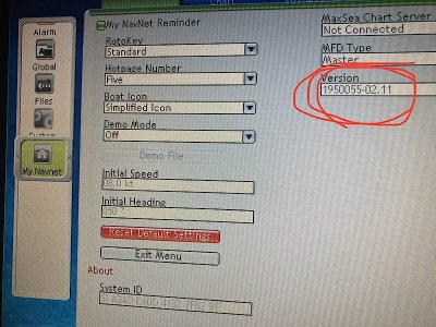

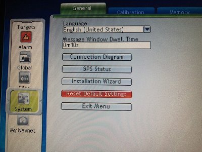

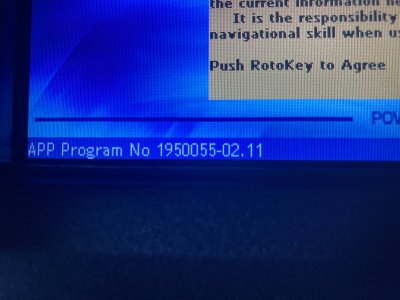

3. The device's properties still display version 1950055-02.11

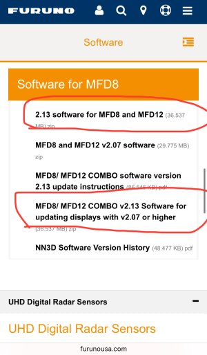

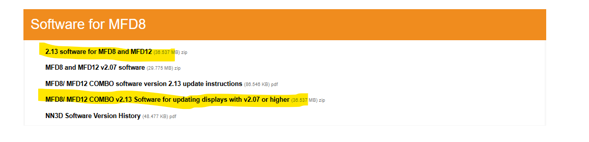

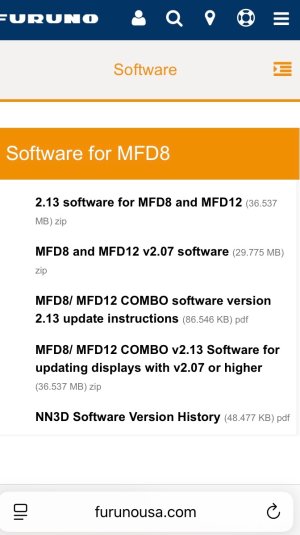

4. I also tried with a FAT32 system SD card. I also tried with the "MFD8 MFD12 v.02.13" file that I downloaded from the same place.
I didn't understand which one was correct or why there were two.
In any case, after all attempts, the version number remains in the properties of my device ....2.11
What should I change in my actions to update the software?
Should I install a intermediate version of the program before upgrading from 2.11 to 2.13? If so, which one?
