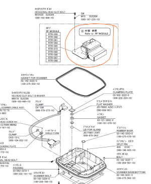

That would be "weak or missing targets". The most likely cause is the magnetron. The tech can check the magnetron using a procedure "check magnetron current" to begin the troubleshooting process to verify.
Or you can send us the transceiver (T/R unit) from the gearbox (4 bolts hold it into the bottom of the gearbox) to be checked by Furuno USA.

You would need to get with your dealer. The Furuno service center doesn't do estimates by e-mail or telephone. They must evaluate the item. They have a $135 evaluation fee that is waived if you repair the unit. Repairs are parts plus labor. List price for the 1932Mk2 Magnetron (part) is $575.
