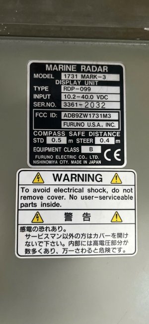

linhkienbodam Furuno Super Fan Jul 10, 2025 #1 My 1731 mark 3 can get target well but It restore to factory setting after turned of 2-3 days. Just thought it is memory battery problem then I opened the display but I can not find any memory battery there. Please help. Thanks in advance
Kraken Moderator Staff member Jul 10, 2025 #2 The 1731 does not have an internal battery. It uses EEPROM to store settings. It could be that the EEPROM memory has failed.
