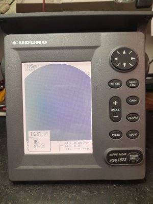

My Furuno model 1623 radar started acting up. For no apparent reason, it started smearing the screen, as if the gain control was all set to 100%. But after checking the various settings, I realized they weren't the culprit. Since I couldn't interrupt the video signal without cutting the cable, I used an old cable to disconnect the video signal on the coaxial cable, pin 6 of the DJ1 connector. But even with the coaxial cable disconnected, the problem persists. The radar only has 75 hours of transmission, so it hasn't worked very well. It wasn't turned on during a thunderstorm. It's a strange defect. I'm attaching two photos to better explain this. Perhaps someone has already encountered the same problem. Sorry for the long message.

pasquale,
It looks like you are zoomed in to 0.125nm. What happens when you zoom out to 5-10nm? Looks like you are just seeing the Main Bang (MB). Also, is MB Suppression turned off? Try backing out to 5-10nm and making sure MB Suppression is turned on. See how it looks then.
We haven't sold a 1623 in a long while. They are good radars. Are you a dealer or service guy? I see from your questions you have asked about a ton of other models. How long is the scanner cable? Was the scanner cable from an older prior system?
pasquale,
Hi Silver, yes, in the photo it was on the 0.125mg scale, but nothing changes on the other scales up to 16mg either. No one touched the main bang, but honestly, I haven't checked it. It's raining here today (in Tuscany, Italy) to keep the radar head away from me outside. The cable has been checked, and it shows no short circuits or insulation losses. I'm a retired technician (76 years old), and this radar is on my small boat. But friends often ask me for advice. I'll do the checks you suggest and post the results. Thanks.
Hi Johnny, yes, I was a technician for many years, now retired (I'm 76). But many friends often ask for advice. I've certainly asked for advice myself in the past, here on the web. I can't possibly know everything, or understand all the flaws that electronic equipment can have. I was very good at autopilots, even very old ones like the NECO. But now I have to deal with my little radar. The original cable is still on the mast; I've tested it, no leaks or short circuits. I'm using a second cable, also from a 1623, which I destroyed; I only recovered the cable, and it's good. It's 10 meters long. Silver gave me some advice, which I'll probably be able to test tomorrow, since it's raining here in Tuscany today. I'll try to post any results. Thanks anyway.

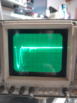

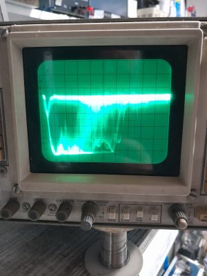

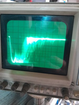

I think I've reached a conclusion in my search for the problem plaguing my little radar. After several checks of the power supply voltages, all of which were fine. I focused on the video signal to see if it was present. I dug my old Tektronix 466 out of its hiding place and examined the video signal. And it is present; by adjusting the gain control, I noticed clear variations in the signal; even changing the range scales showed the pulse variation. So I believe the black screen on all bands is due to the video part on the display board. RDP141. I can't repair it; I'll look for a used one. I'm attaching some photos of the video signal, for anyone who wants to see what it looks like before processing.
Nice troubleshooting. While the radar isn't sold anymore, it is likely possible to still order a new display if you wished or get a used unit. There are many on the market because the radar was sold for roughly a 20 year period.
Hello Johnny, I'd like to ask you a question. On the Furuno 1623 radar, if you hold down the down arrow button while turning on the device, it should perform a master reset, right? If the menu remains exactly as it was before the operation, as in my case, it means there's a problem with the electronics. I think this sequence should reset the device to its default settings, or am I wrong? Thanks.
It depends on the software of the unit somewhat. That series was sold for 20 years.
