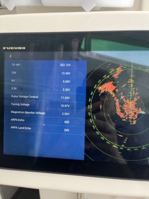

Please run the RADAR in transmit on th 24NM range and select HOME- SETTINGS - RADAR - RADAR MONITORING attach a picture of the monitor results.
Wow that was quick! Thank you. Attached is a pic of what you asked for.
However, I just did a factory reset. The radar came back blank with no change from before, but after 2min it started working and showing targets as expected. I am now letting it run to see if the problem returns. I will also be turning it on/off a few times to see if it continues to work.
I'm concerned about it losing its power and connection. I wouldn't think a factory reset would affect that type of thing.
BTW, with the exception of the ARPA echo parameters, these are the same values the monitoring page was showing when it wasn't working.

The tune voltage is out of spec. The tune voltage when properly tuned should be around 6V. Put the RADAR into manual tuning see if you can tune in a decent RADAR picture.

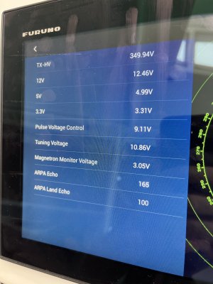

Here is what the monitoring shows while it is working fine. We are in a marina, so all of those close targets are other boats.

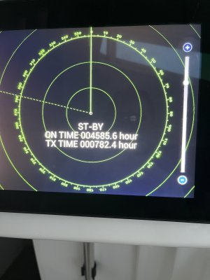

Your TX-Time is pretty low, if it was close to or over 5,000 hrs. the magnetron would be suspect. Please try the manual tune again and manually tune it up to get the best possible RADAR picture. please get a picture of where the tune voltage is to get a decent picture. The RADAR should be the best at approx. 6V tune voltage. If it is 10V to get the best picture, we would have to get the dome sent in to see if it is a transmit (TX) or receive (RX) problem.
The best manual tune is right where the autotune sets the tune voltage (10.8V). There remains a decent return picture down to 10.1V, but it starts to fall off lower than that.

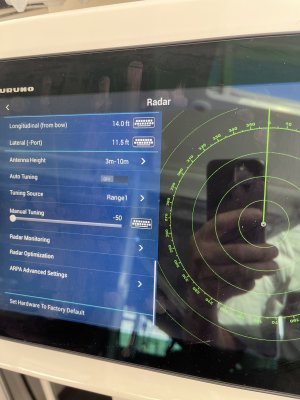

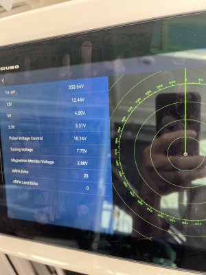

The lowest I can make the tune voltage with manual tune all the way to the left is 7.8V, where there are no returns at all. I cannot achieve 6V, as manual tuning doesn't go any lower. Turning the manual tune all the way up doesn't change much and maxes out ~11.2V
Pic 1 tune voltage turned all the way down (7.8V)
Pic 2 radar monitor page with tune voltage all the way down
