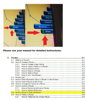

Thanks for your reply. I must be really bad because I cannot find the hide routes using the roto/routes/ ? key. Can you draw a mental picture for me. Thanks.

PLEASE ALSO NOTE: If you don't see the finger selection on the Roto-key, please hold in the Roto-key to enable all fingers and then verify the setting. Customizing the Roto-key is another subject but this might be what has you hung up.
