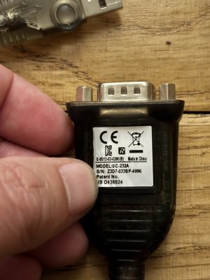

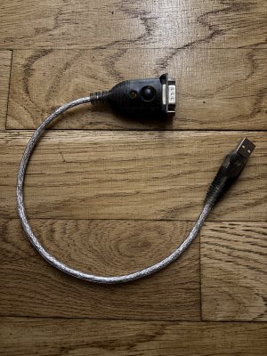

Please show the USB to 232C converter you are using and the wiring. You also need to see what comm port the USB adapter is using and baud rate.
IMG_4345.jpegIMG_4344.jpegHello, I use an ATEN UC-232A and the comm port was 3 but I change the Dport in the up.bat to 3 and the led of the adapter was blinking very fast so it seems to work. Comm port is on default speed and I also try on 4800
