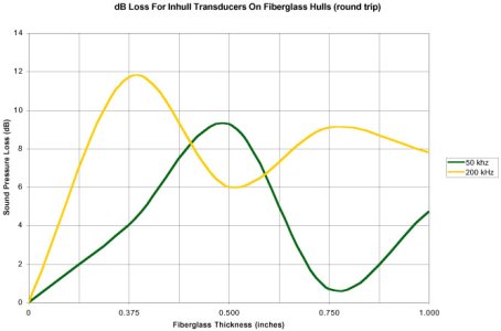

fcv292 w/3kw output with 3kw 50 kHz transducer question.
If I use a wet box filled with mineral oil inside my fiberglass single skin 25' chris craft straight inboard will I be able to read down to 3500 feet? The speed of the boat will
not exceed 10 knots. Sea state will never be more than 3 ft. I am to old to be bounced around. Second question, will I be able to tell what kind of bottom-mud, sand, rock-
in 800 feet of water? Thanks in advance.
