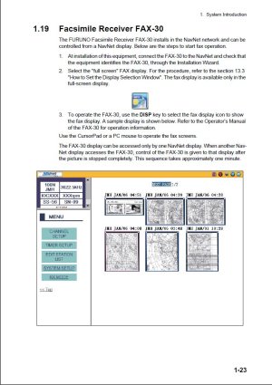

I have the MFD12 and the Fax30 connected....how I can use it?
I use the Netgear hub and the led light...but I can't get it on the sceen...
Thanks. Giovanni Fabio
Hello gifabio,
The instructions for how to setup the FAX30 and the MFD12 are contained on one page in the MFD12 Operator's Manual. I have extracted that page and I'm attaching it to my response.
Take a look at it and see if you still have further questions.
