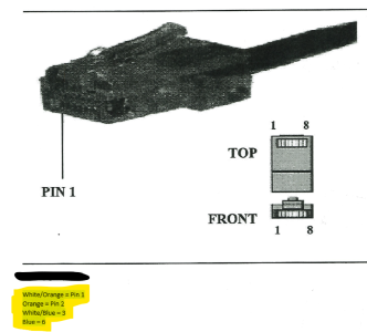

Hello. I have an MFD8, MFD12, and DRS2D radar connected through a Hub101. I have the power side of the DRS cable connected directly to the DRS port on the MFD12 and the Ethernet side of the cable connected to one of the ports of the Hub101. The Furuno Ethernet cable only uses two pairs of wire and pins 1,2,3, and 6. I see by looking at the wiring diagram that the pinouts are crossed between the Hub101 and the radar unit. My question is does the DRS cable have the pinouts already crossed on the RJ45 connectors. I have to replace the RJ45s and want to make sure I get the pinouts correct. Thank you.
Ultimately the DRS ports are auto sensing so you can wire it as a straight or cross-over and it will work either way. The scanner cable is a crossover. Here is the normal pin out.
