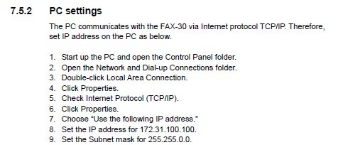

Hello i just want to make sure that the HTTP adress for PC usage of the FAX-30 is the one still published in the documentation : 172.31.8.1
Altough i can access it from the Navnet3D, this adress is not existent from the PC connected to the HUB 101 (which host my Maxsea software and thus is in communication with the Navnet)
Thanks for the help,
Andre
