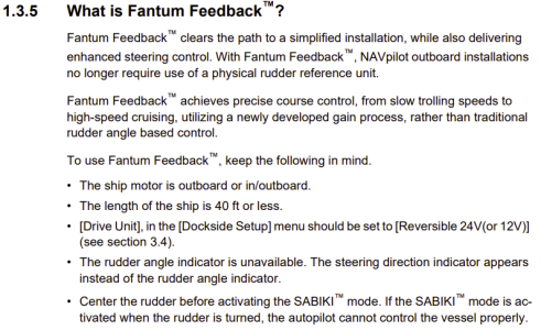

I have a navpilot 711c on my displacement hull vessel. I've read that Fantom Feedback is meant for outboards. However, I'm wondering is it an be be used in a pinch for a displacement hull with inboard engine and rudder.....For instance, if your RRU goes out while far from port. Can you set up Fantom Feedback to keep the AP working to some extent?
Also, is there any additional information available on how to use this feature besides what's in the manual?
