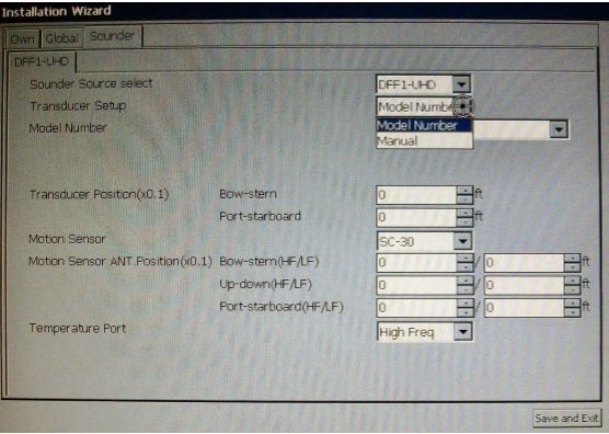

I am pretty happy with my electronics setup, however I feel like my transducer settings are not correct in my DFF1-UHD sounder (via the MFD12 install wizard interface). This is because the DFF1-UHD only has default settings for the 265 transducer.

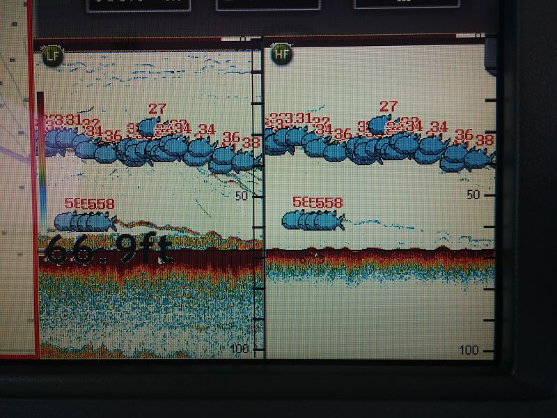

As a side note, the orange transducer wire is not connected, and the system reads depth, etc with no problems (pic at bottom). Last weekend I updated the firmware for all of the components (MFD to 2.13, SC30 to 3.02, sadly, no updates are available for the DFF1) but nothing changed in the sounder configuration.
I cannot seem to determine the actual numbers that need to be input into the installation wizard (on the MFD12) when under the sounder/DFF1-UHD tab.
The numbers required are for Low Frequency and High Frequency.
However, the input area references that the number input needs to be calculated.
(divided, or something)
So, if a TM275LH-W transducer has a low of 42 to 65 KHz, and a high from 150 to 250 KHz, how does one come up the with single number that goes into the field?
I considered just setting it for the default 265 transducer, but the frequencies are a little different and I didn't know if this would cause issues or not use the 275 transducer at its best. (265 transducer settings: low 42-65, high 130-210)

(Since taking this picture, I have quit using Accu-Fish and started trying to read my unit better, its a work in progress)
