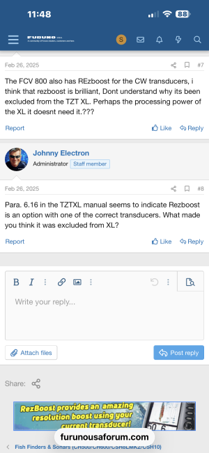

Would I have better sounder performance if I ran the transducer through a TZTXL display instead of the DFF1-UHD+. It is my understanding that the sounder module in the MFD does have Rezboost capability correct. If yes are the sounder modules the same for 10,13, & 16?
Sitkatroller,
The RezBoost feature is not available for TZTXL, primarily because TZTXL now includes CHIRP capability. However, TZTXL still supports Accu-Fish and Bottom Discrimination when used with a compatible CW transducer.
-Deep Blue 🤨

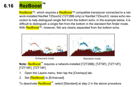

Sitkatroller,
Please see section 6.16 in the TZTXL manual. To run RezBoost on a TZTXL, you will need to have a NavNet TZT2BB or a NavNet TZtouch 3 networked to the XL.
Because the B260 (526TID-HDD) has multi-elements on the LF side and both are tuned to the freqs they are working at, it is unlikely Rezboost would offer you much. Rezboost is about post processing target separation for C/W transducers. Because of the multi-elements it will not make as much of a difference compared to a transducer that only has a common element like the B60 or V744V. If that is the focus and the other items about the newer units are not important, some money can be saved by getting the TZT3 and having the feature. Do I think you will see much of a difference using that transducer? No
