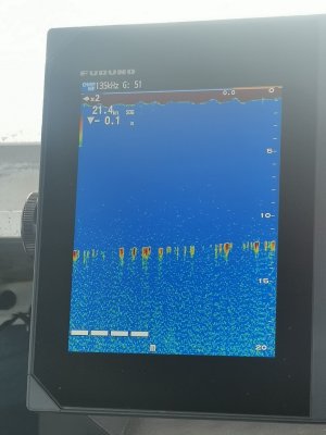

Usually, a speed related issue is due to cavitation. Can you attach a picture showing the screen at the speed at which you lose the bottom? Are you seeing the onset of a lot of noise at the surface when you lose the bottom?

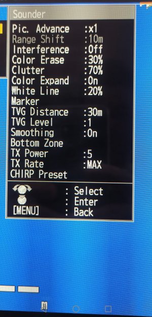

This is a recent pic of it trying to hold bottom at 21 knots in shallow water with what I believe was the settings at the time. When going to deeper water it dropped out. I had a bit more success than previous trips by changing the frequency band on the SS175M to 135khz manual, and selecting range to manual to match the depth. But it still left much to be desired.
