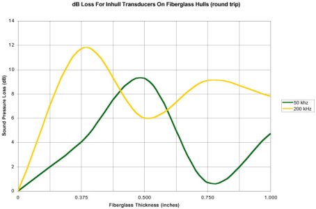

I can install it exactly on the centerline, but think there the hull is little bit thicker. You still recommend the exact centerline (the box will be cut in v shape)? If choose the R299 3kW there will be any performance loss for 500 meters depth?
Chrysmon,
Yes there will be performance loss. Below is a chart from Airmar that shows round trip signal loss in db vs hull thickness.
