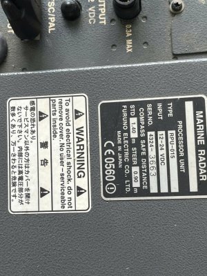

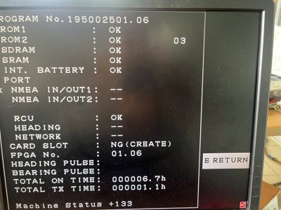

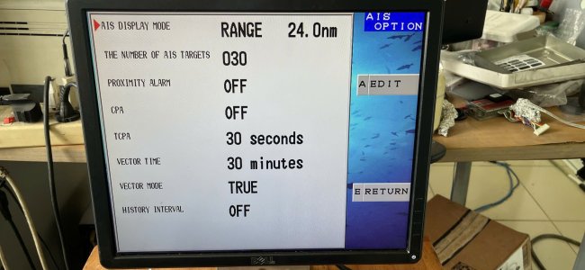

I can not open AIS function on my VX2 RPU-115. I tried to set it to factory default setting but can not fix it. Please help

If you are not using a IF-1500 you will need to update your software. You are several versions behind.
In the notes for V1.08
"6. IF-1500 not necessary for AIS indication (IF-1500 CANNOT be connected with new software)"

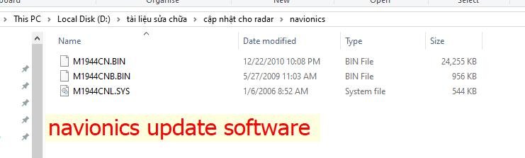

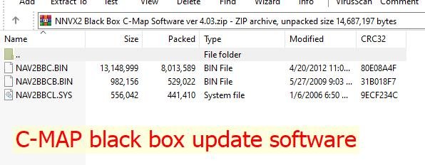

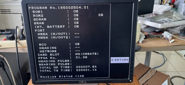

I connect and get AIS from my GPS. I have Navionics Update software and I have updated my black box but It did not read my SD card (I am using FAT 2GB SD), it seems It is used for 10" display only. Do you have Navionics update software for my Black box? I only found update software for C-MAP Black box only. Thank you

Sending you a software link.

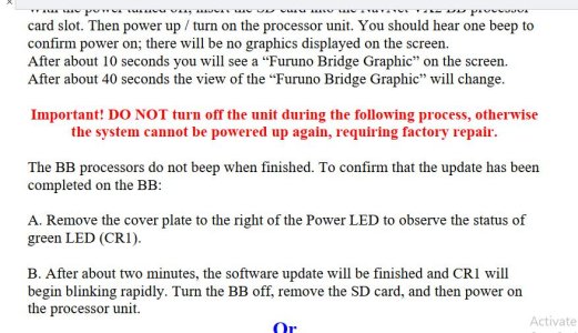

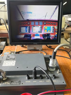

I am updating the system and my RPU015 has been running for 20 minutes and the Furuno Bridge Graphicno doesn't change on the display so I am not sure if the update has been completed or not. What should I do next? It is said that I should not turn the unit off if the processing is running

The update is completed on the BB and I can open AIS function. Thanks so much for your help
