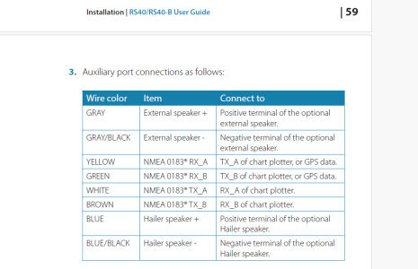

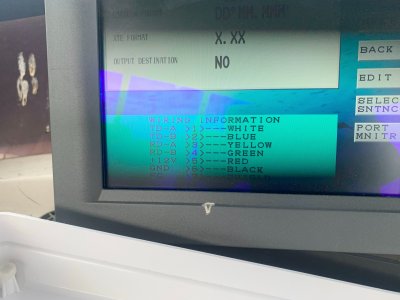

Spent hours trying to figure this out before posting here. I am attempting to display AIS targets on an RDP-149 by connecting it to a Simrad RS40-B AIS. My present settings/connections are as follows:
White wire TX_A from the AIS is connected to yellow wire RD-A on the MFD
Brown wire TX_B from the AIS is connected to green wire RD-B on the MFD
NMEA 0183 from AIS is connected to DATA2 on the MFD

My local offset is UTC-5. I can't figure out how to change +00:00 to a negative value. The attached image only allows a positive value to be entered.

The UTC +/- button appears on the same button you pushed to edit the value (one of the five buttons on the right side of the screen).

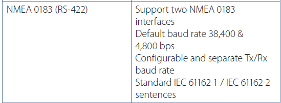

The Simrad RS40-B User Manual shows NMEA 0183 states IEC 61162-1 & -2. This indicates that it's at least v3 or higher, so it may not be compatible with the RDP-149
I also found in the Simrad RS40-B User Guide that there is a checksum setting. It seems to imply it only affects input, but I would toggle the checksum setting to OFF. Also, the Time Offset setting...ensure it's set to the -5 hour offset as well. If you are in the Eastern Standard Time (EST) time zone, we are currently -4 hours due to daylight savings (DST). Might try changing it to that here and also on the RDP149 (with DST option set to OFF).
