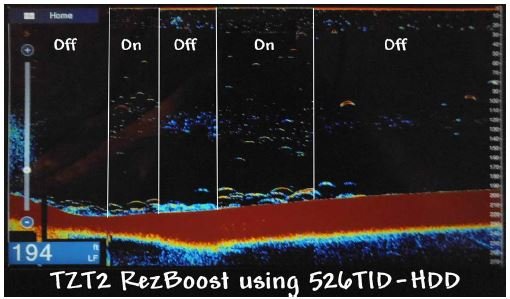

Smaller hulls equal a shallower draft so you are going to see more turbulence with any transducer you use unless you pole mount one. Can you see hardness changes in the primary echo, yes you can. But you will be see more subtle changes by using the 2nd or third returns than the primary. Pole mounting a CA50/200-1T with a MB-1100 is my first choice and the second would be using the 526TID-HDD with the fairing block. Below is a screen shot of a TZT2 with the 526TID. The 1T will better at showing hardness changes in the primary return where you will need to use the 2 or 3rd return with the 526TID.
