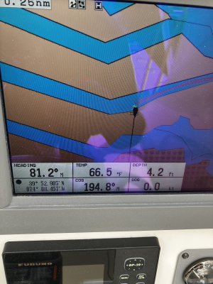

So with the 6/10 everything works, got a dff1 set it for vx2 have sounding but lost temp. Switched everything back to 6/10 then I get temp back.
Boat has a airmar b260. Any ideas?
Thanks
John

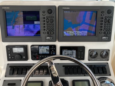

Have to look at the light but I think it’s
communicating. The two 10.4s show the same scan of the bottom.

It is not in simulation mode. Tried it again 6/10 has temp dff1 does not. Dff definitely has a better scan of the bottom so it's working just no temp
