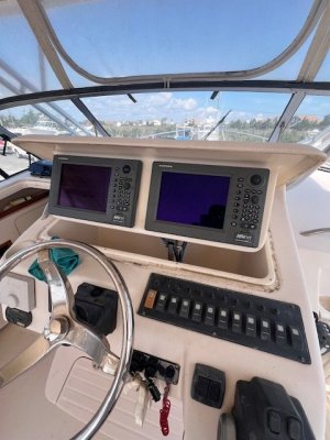

I just purchased a 2008 GW that has a full Furuno set with the NAVnet vx2 Navionics gold, radar, sonar, chart plotter. The problem is I am a Garmin or Raytheon user and familiar with NEMA2k and I'm a little lost. My first thought was to take out all and put a new Garmin system in, but everything works and seems like it works well, so maybe I just leave it in place. Can I get some guidance on the following?
I have 2 RDP 149 displays with 2 additional smaller displays with depth, temp, lat/long, and a Simrad AP.
  1. Is there a black box somewhere that ties them all together, or do they function via the 149 units?

Is there a black box somewhere that ties them all together, or do they function via the 149 units? ANSWER: each unit is an independent processor referred to as a Multifunction Display (MFD). They communicate with the other units via Ethernet.
