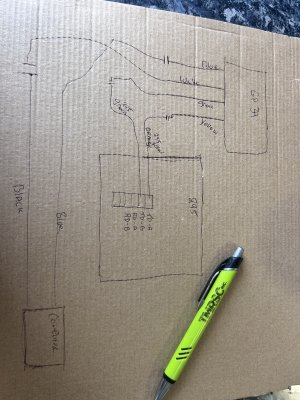

I’m currently having some issues wiring my system.
Untill recently I had a 295 talking to an old Garmin 95SV which in turn sent the depth and position data to a computer for maxsea through the com port.
Recently the Garmin 95SV failed.
I’ve replaced the Garmin with a Furuno gp39
And can’t seem to get the system working again.
It seems I can either have depth data or position data coming though to the computer, but neither at the same time.
Will the GP39 accept the depth data then send that information to computer along with the position data at the same time?
I’ll attach a picture of my wiring diagram i currently have.
